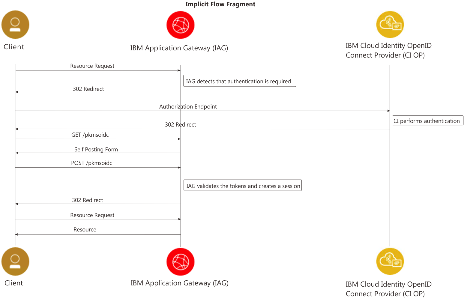

Authentication Flows
The OIDC specification states that authentication can follow one of three paths: the Authorization Code Flow, the Implicit Flow, or the Hybrid Flow. The flow determines how the ID Token and Access Token are returned to the Client. The Authorization Code Flow and the Implicit Flow are described below (please note that the IAG does not support the Hybrid Flow).
The Authorization Code flow is the default and recommended flow for the IAG, but it does require direct connectivity from the IAG container to the IBM Security Verify OP. If direct connectivity is not possible the Implicit Flow may be used - although this flow is not recommended and is now considered a security best practices anti-pattern. There are two subtle variations to the Implicit flow, differentiated by the originator of the self-posting form (this form is used to POST the authentication tokens to the RP):
- The 'fragment' sub-flow uses a self-posting form which is served from the IAG container;
- The 'form-post' sub-flow uses a self-posting form which is returned from the IBM Security Verify OP as a result of the authentication process.
Implicit Flow (fragment)
Implicit Flow (form-post)

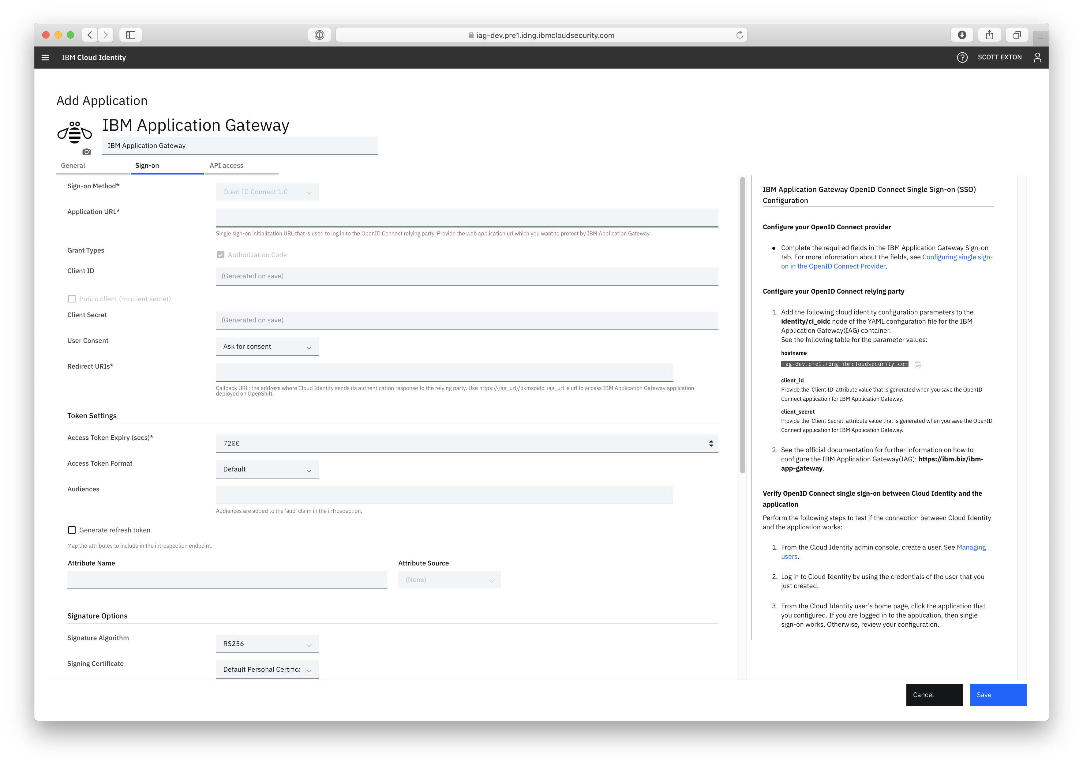

To configure the OIDC flow between IBM Security Verify and IAG you have to first create a IBM Security Verify application, using the 'IBM Application Gateway' template, to represent the IAG application.
Information on how to create an application can be found in the IBM Security Verify documentation: https://www.ibm.com/support/knowledgecenter/en/SSCT62/com.ibm.iamservice.doc/tasks/t_applications.html#t_applications__create_app.
The application configuration screen will have some of the application fields pre-configured for IAG. At a minimum the following sign-on fields will need to be provided:
- Application URL;
- Redirect URIs.
In order to configure the IAG to act as an RP the following IBM Security Verify information will be required:
- Security Verify endpoint;
- Client ID;
- Client Secret.
