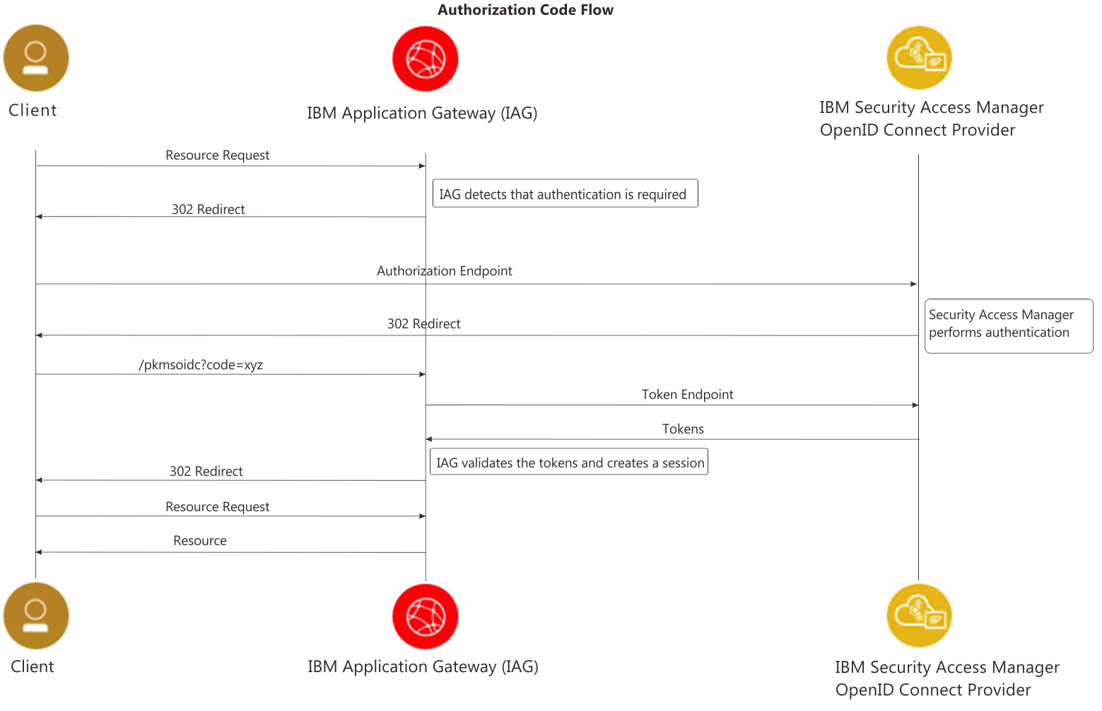

The OIDC specification states that authentication can follow one of three paths: the Authorization Code Flow, the Implicit Flow, or the Hybrid Flow. The flow determines how the ID Token and Access Token are returned to the Client. The Authorization Code Flow and the Implicit Flow are described below (please note that the IAG does not support the Hybrid Flow).

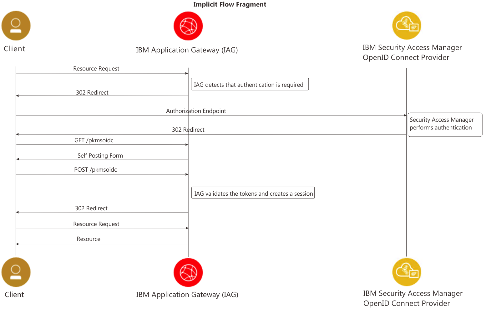

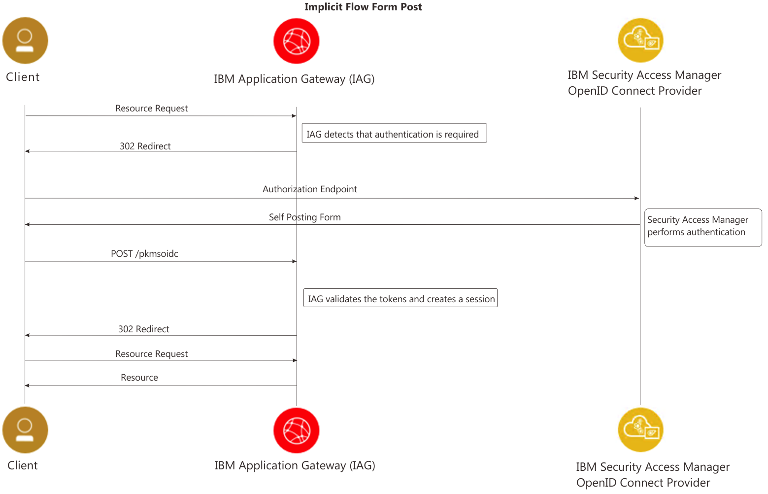

The Authorization Code flow is the default and recommended flow for the IAG, but it does require direct connectivity from the IAG container to the Security Verify Access OP. If direct connectivity is not possible the Implicit Flow may be used - although this flow is not recommended and is now considered a security best practices anti-pattern. There are two subtle variations to the Implicit flow, differentiated by the originator of the self-posting form (this form is used to POST the authentication tokens to the RP):
- The 'fragment' sub-flow uses a self-posting form which is served from the IAG container;
- The 'form-post' sub-flow uses a self-posting form which is returned from the Security Verify Access OP as a result of the authentication process.
Implicit Flow (fragment)
Implicit Flow (form-post)

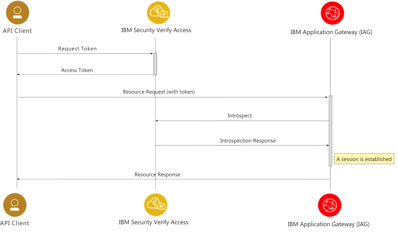

The IAG can receive an OAuth Bearer Token in a HTTP 'authorization' header, and then call out to an OAuth introspection endpoint to validate the bearer token. The information contained within the introspection response is then used to establish an authenticated session.
Authentication Flows
The first thing which an API client must do in the flow is obtain an OAuth Access token from the OAuth identity provider. If IBM Security Verify Access is the identity provider this can be achieved by accessing the token endpoint (https://{verify-access-hostname}/{junction}/sps/oauth/oauth20/token).
This access token can then be provided as a Bearer Token to the IBM Application Gateway in the 'authorization' HTTP header of the request. For example:
Authorization: Bearer wj0LQ4tPUDTz5LIleVLQkgUc1punUKUfFnBmWy1p
The following diagram highlights the flow:
