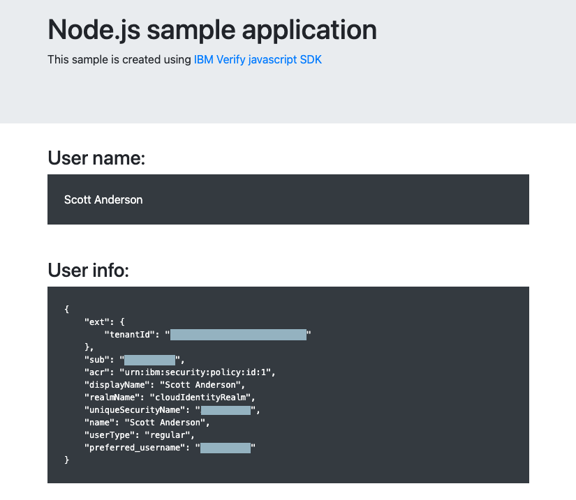

Once authentication is complete, you'll be re-directed back to your sample application. It will complete the single sign-on flow to get access to identity information for the user that authenticated. The information received is displayed in the browser:

Available attributes
The attributes that are shared from your IBM Security Verify tenant to the application are controlled by the requested OpenID Connect scopes and by the configuration of the Developer Portal (which is set by your tenant administrator).
If you want to receive additional information, try adding additional scopes to the .env file of the sample application:
SCOPE=openid profile email phone
