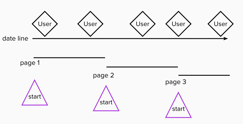

Here is a graphical way to think of this:
1353
The algorithm here is:
  1. As long as the last and next to last have the same created date, drop the last one (we may drop many)
  2. Now that the last and next to last have different dates do:
  3. Record the last created Date as the new Starting date for the next search
  4. Drop the last one as it will be the first one in the next search.
After this, we will add the remaining list to our full User List. And repeat the search with the new start date, repeating the process for the next page of data.
It is to note, so for each page we get 2000 users but will always add a few less to the overall list, in order to find a "real" breaking point.
