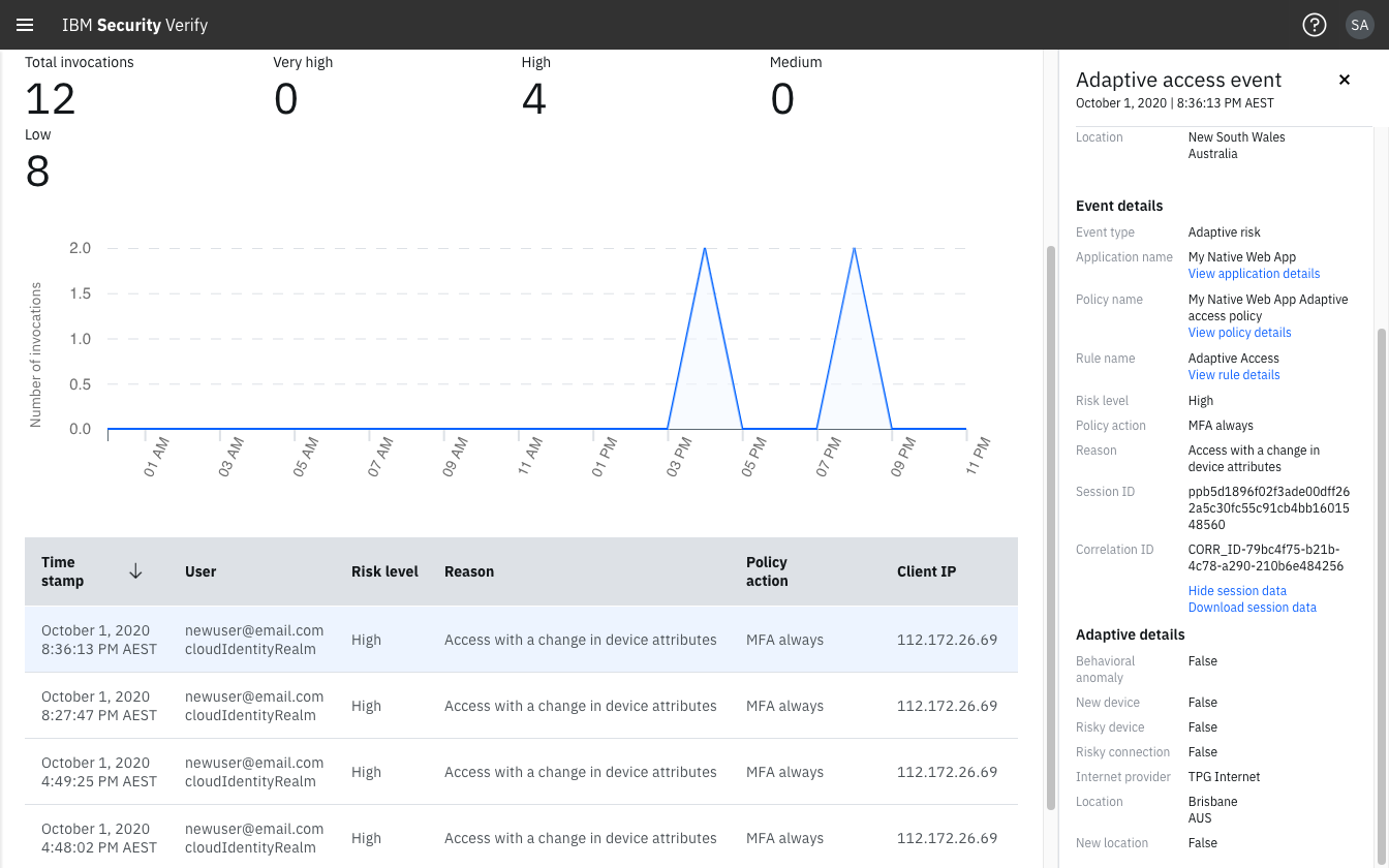

Change in user or device attributes
Adaptive access uses deep identity insights, through a sophisticated risk calculation engine (IBM Trusteer®), to accurately match Access policies to the user profile throughout their digital interaction with the application.
During collection, detection and assessment the Session ID
may have been evaluated by the risk calculation engine differently to the expected manual testing process.
A range of indicators may alter the assessment result including:
- user was not new
- user had a pending MFA from a previous session
- location, device or behavioral patterns changed significantly
Event details view for "Access with a change in device attributes"
