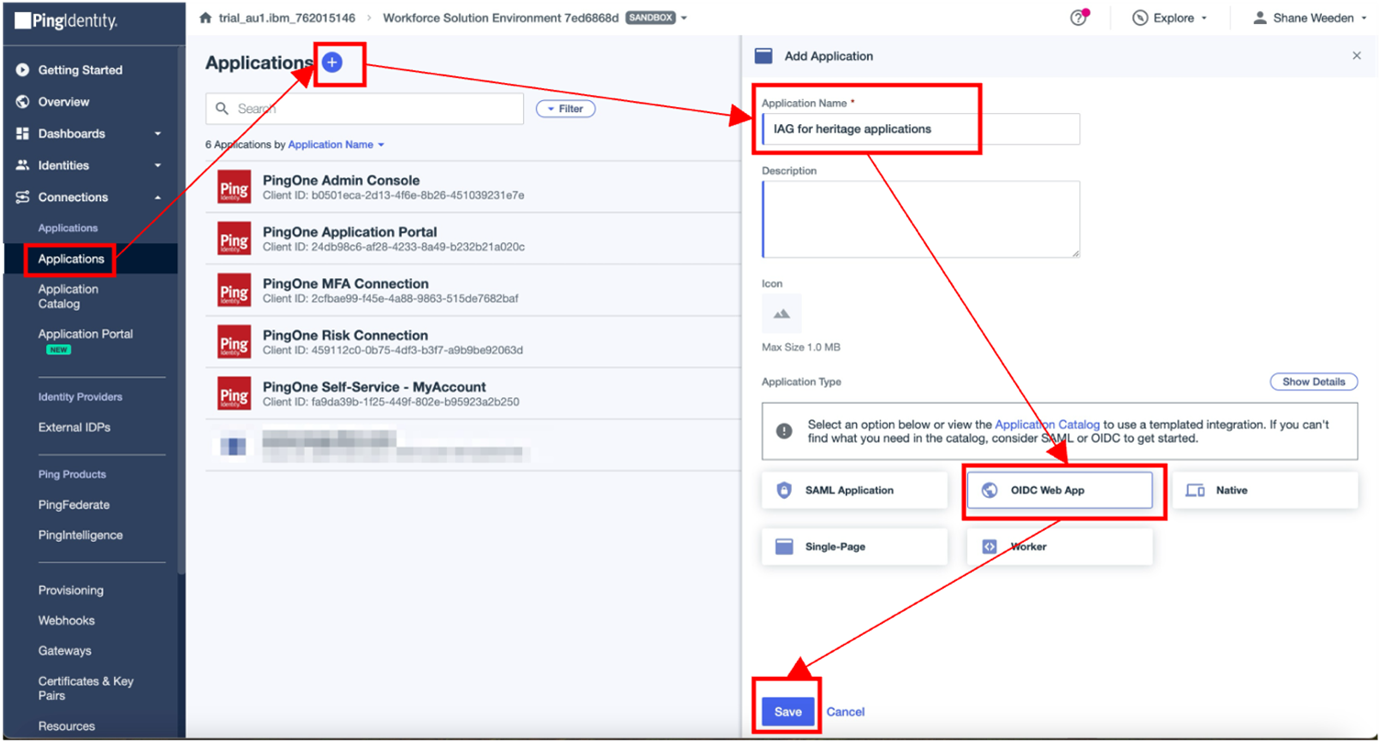

Browse to Connections > Applications and click + to add an Application. Complete the Application Name field, set the Application Type to OIDC Web App, and click Save.

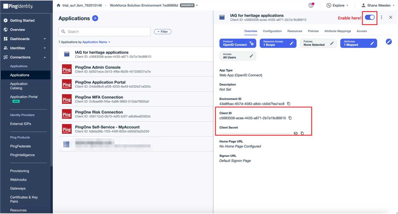

The application must be enabled before it can be used by toggling the enable switch. Browse to the Overview tab and note the Client ID and Client Secret value.
In IAG, the Client ID is used in the client_id field, and the Client Secret is used in the client_secret field.
The generated Client ID and Client Secret values in this example are:
- client_id
c5683508-acee-4435-a871-2b7a19c86610 - client_secret
zF57tApDDikZqg7Zj2kMARYHkzvr1cenWdBt_.tq8~xw-haIjXqZ0EuAgLodxRZD

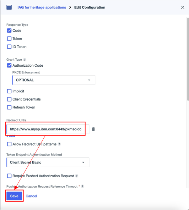

The configuration for the application must be updated to include the IAG redirect URI. To edit the application configuration, on the Overview tab click Protocol OpenID Connect to open the Edit Configuration window. Complete the Redirect URIs field and click Save. None of the other parameters on the Edit Configuration window need to be updated.
The Redirect URI is of the format https://<iag>/pkmsoidc. See Redirect URI for more details.

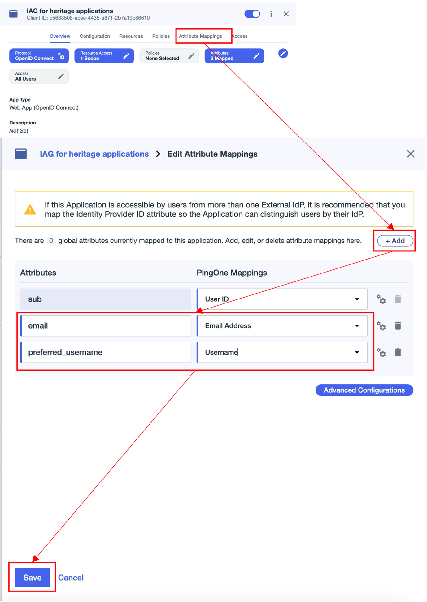

Supplying extra user attributes in the id_token
A protected application often requires extra user attributes from the third-party identity provider. The user attributes need to be propagated to IAG as claims in the id_token.
To configure extra attributes in PingOne, browse to the Attribute Mappings tab and then click Add. Complete the Attributes field and select the appropriate PingOne Mapping for the attribute. Click Save once all required attributes are added.
This example illustrates adding the email and preferred_username attributes.

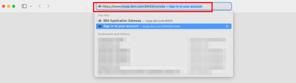

- Browse to the IAG credential viewer application. For more information, see Common IAG Configuration for information about this URL. In this example, the URL is
https://www.mysp.ibm.com:8443/ivcreds.

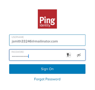

- The browser is redirected to PingOne for authentication. The browser will be returned to the credential viewer application after authentication is completed.

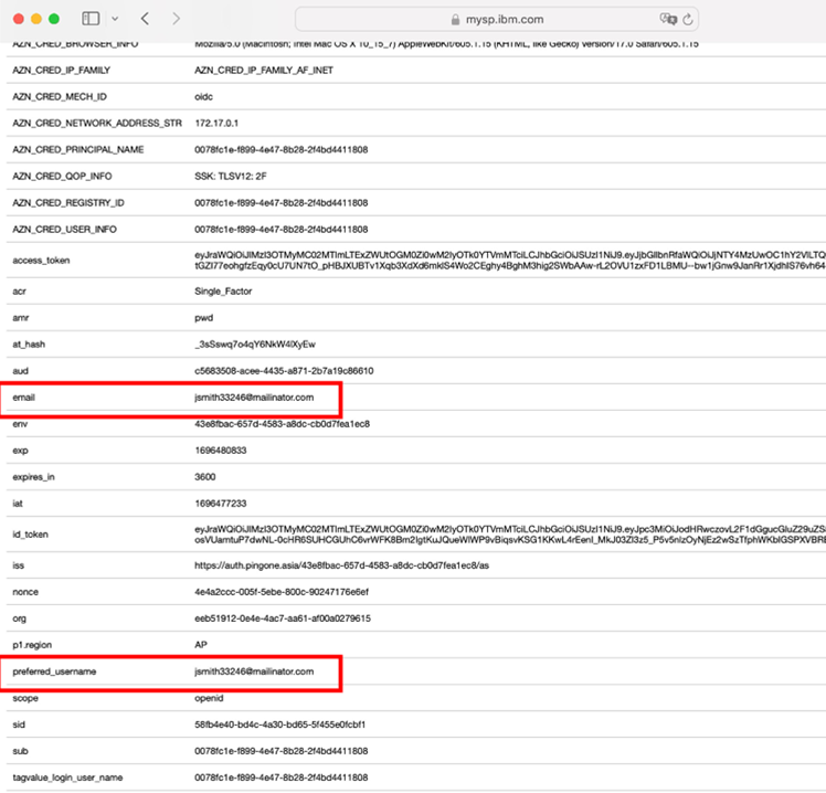

- The credential viewer application is displayed. Observe that the configured
id_tokenattributes (see Supplying extra user attributes in the id_token) are displayed.
