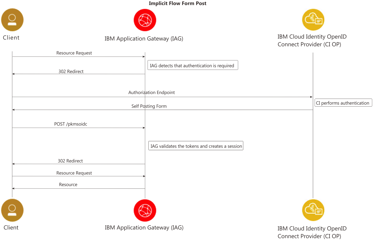

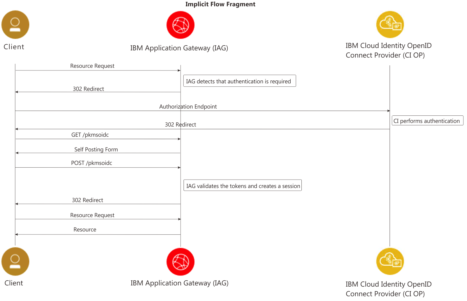

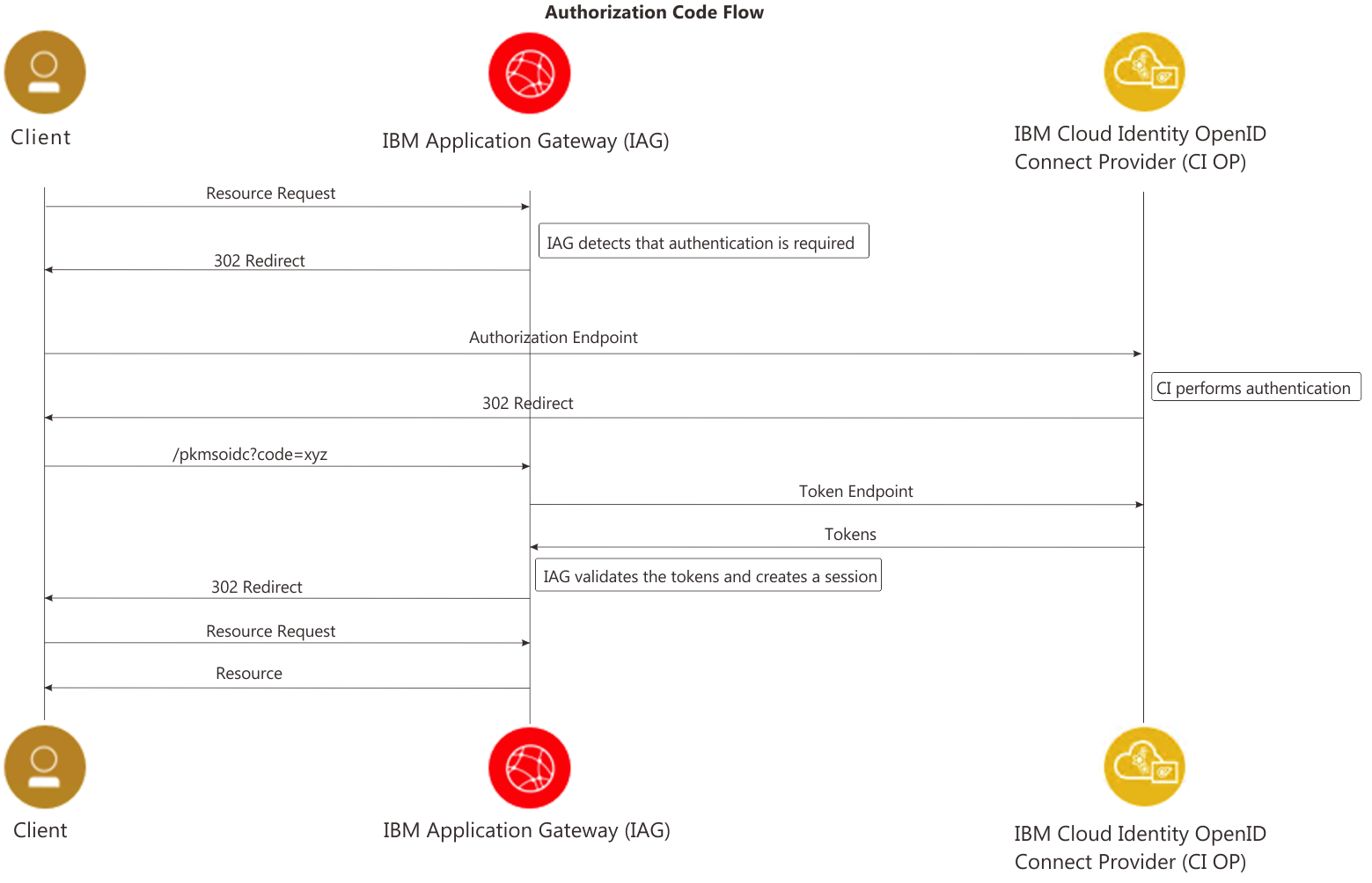

The Authorization Code flow is the default and recommended flow for the IAG, but it does require direct connectivity from the IAG container to the IBM Security Verify OP. If direct connectivity is not possible the Implicit Flow may be used - although this flow is not recommended and is now considered a security best practices anti-pattern. There are two subtle variations to the Implicit flow, differentiated by the originator of the self-posting form (this form is used to POST the authentication tokens to the RP):
- The 'fragment' sub-flow uses a self-posting form which is served from the IAG container;
- The 'form-post' sub-flow uses a self-posting form which is returned from the IBM Security Verify OP as a result of the authentication process.

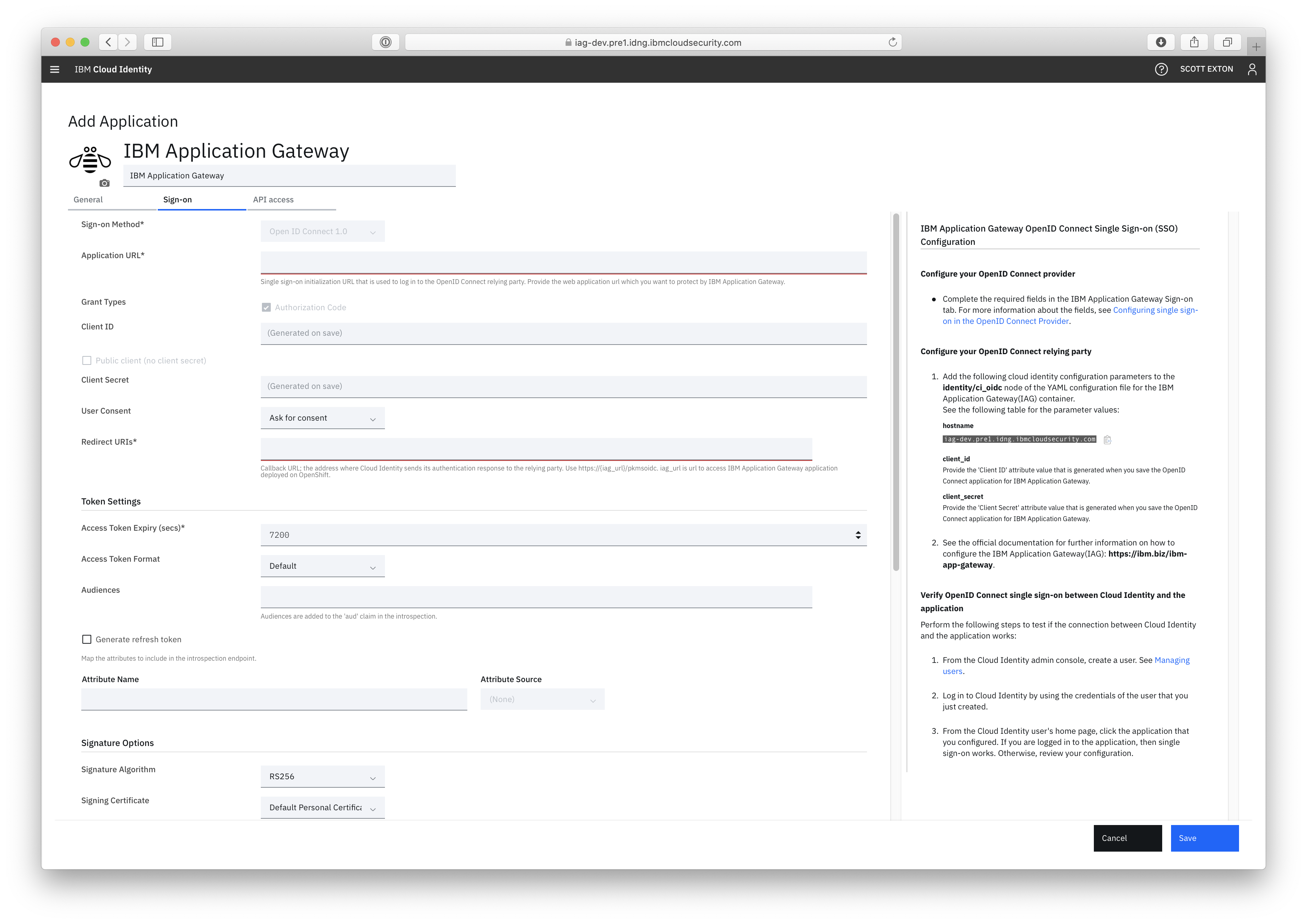

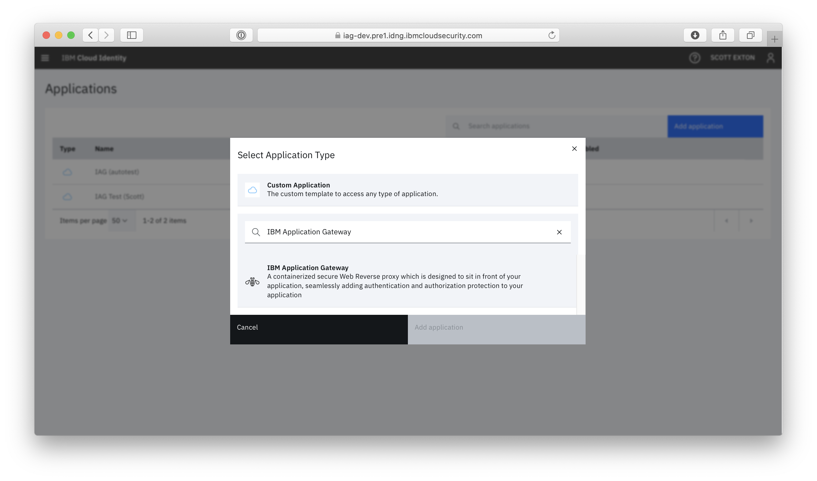

To configure the OIDC flow between IBM Security Verify and IAG you have to first create a IBM Security Verify application, using the 'IBM Application Gateway' template, to represent the IAG application.
Information on how to create an application can be found in the IBM Security Verify documentation: https://www.ibm.com/support/knowledgecenter/en/SSCT62/com.ibm.iamservice.doc/tasks/t_applications.html#t_applications__create_app.
The application configuration screen will have some of the application fields pre-configured for IAG. At a minimum the following sign-on fields will need to be provided:
- Application URL;
- Redirect URIs.

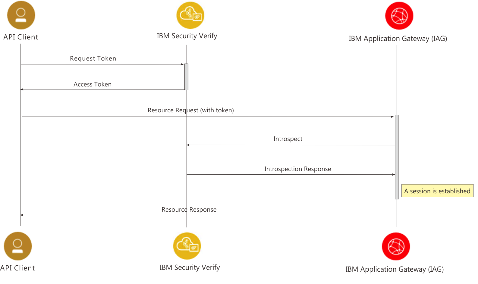

The IAG can receive an OAuth Bearer Token in a HTTP 'authorization' header, and then call out to an OAuth introspection endpoint to validate the bearer token. The information contained within the introspection response is then used to establish an authenticated session.
Authentication Flows
The first thing which an API client must do in the flow is obtain an OAuth Access token from the OAuth identity provider. If IBM Security Verify is the identity provider this can be achieved by accessing the token endpoint (https://{tenant}/v1.0/endpoint/default/token). An example curl command which illustrates how to retrieve an Access Token from IBM Security Verify is available in the product documentation: https://www.ibm.com/support/knowledgecenter/SSCT62/com.ibm.iamservice.doc/concepts/get_access_token.html.
This access token can then be provided as a Bearer Token to the IBM Application Gateway in the 'authorization' HTTP header of the request. For example:
Authorization: Bearer wj0LQ4tPUDTz5LIleVLQkgUc1punUKUfFnBmWy1p
The following diagram highlights the flow:

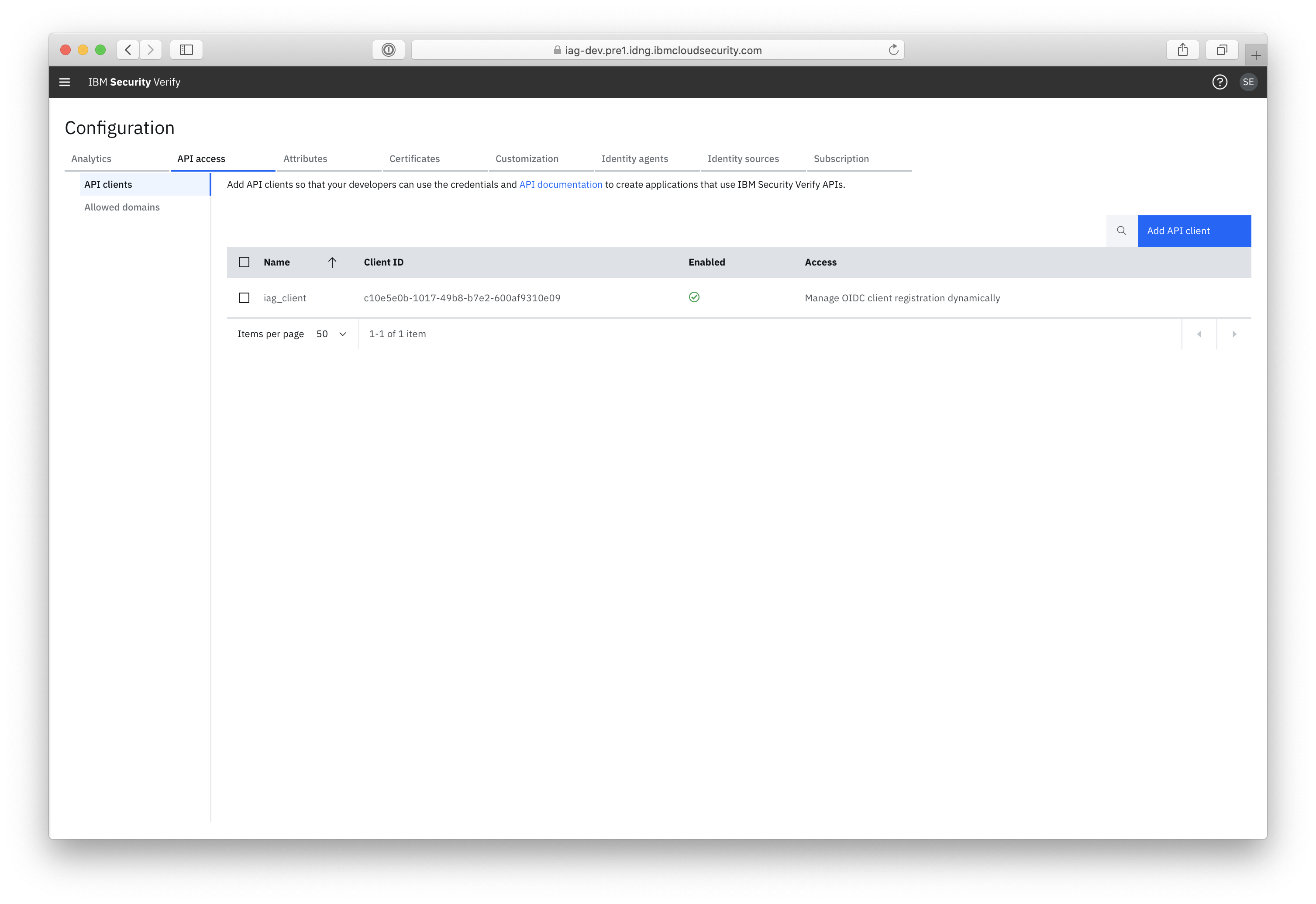

IBM Security Verify
To support OAuth introspection you first need to create an API client for IBM Security Verify using the 'API Access' tab from the Configuration panel of the management UI:
Information on how to create an API client can be obtained from the product documentation: https://www.ibm.com/support/knowledgecenter/SSCT62/com.ibm.iamservice.doc/tasks/api_clients.html#api_clients.
In order to configure the IAG for OAuth token introspection the following IBM Security Verify information will be required:
- Introspection URL;
- Client ID;
- Client Secret.
