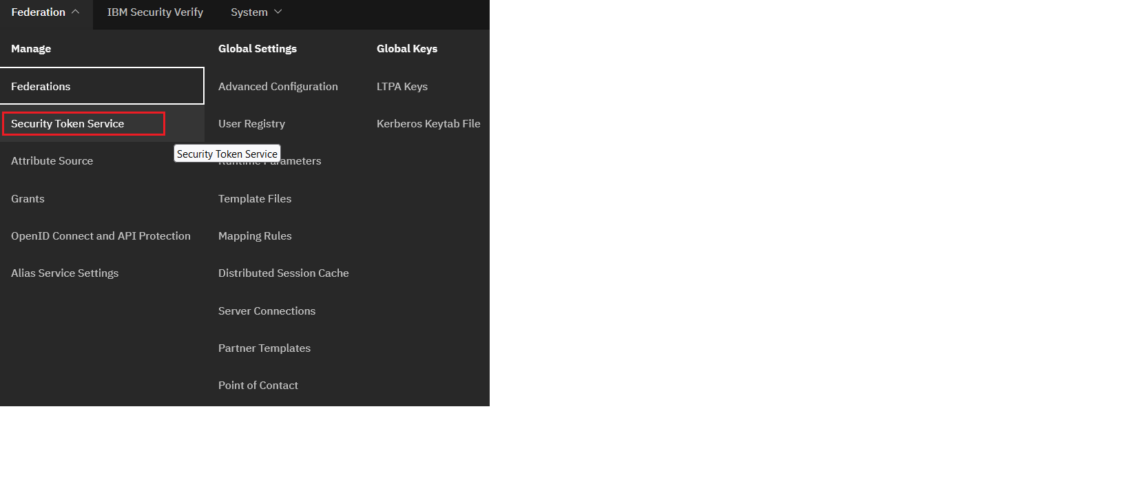

- Navigate to Federation -> Secure Token Service

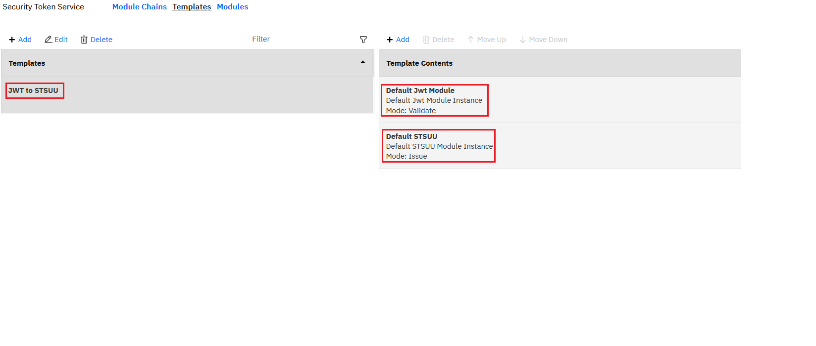

- Configure a Template with Default JWT Module (Validate Mode) and Default STSUU(Issue Mode).

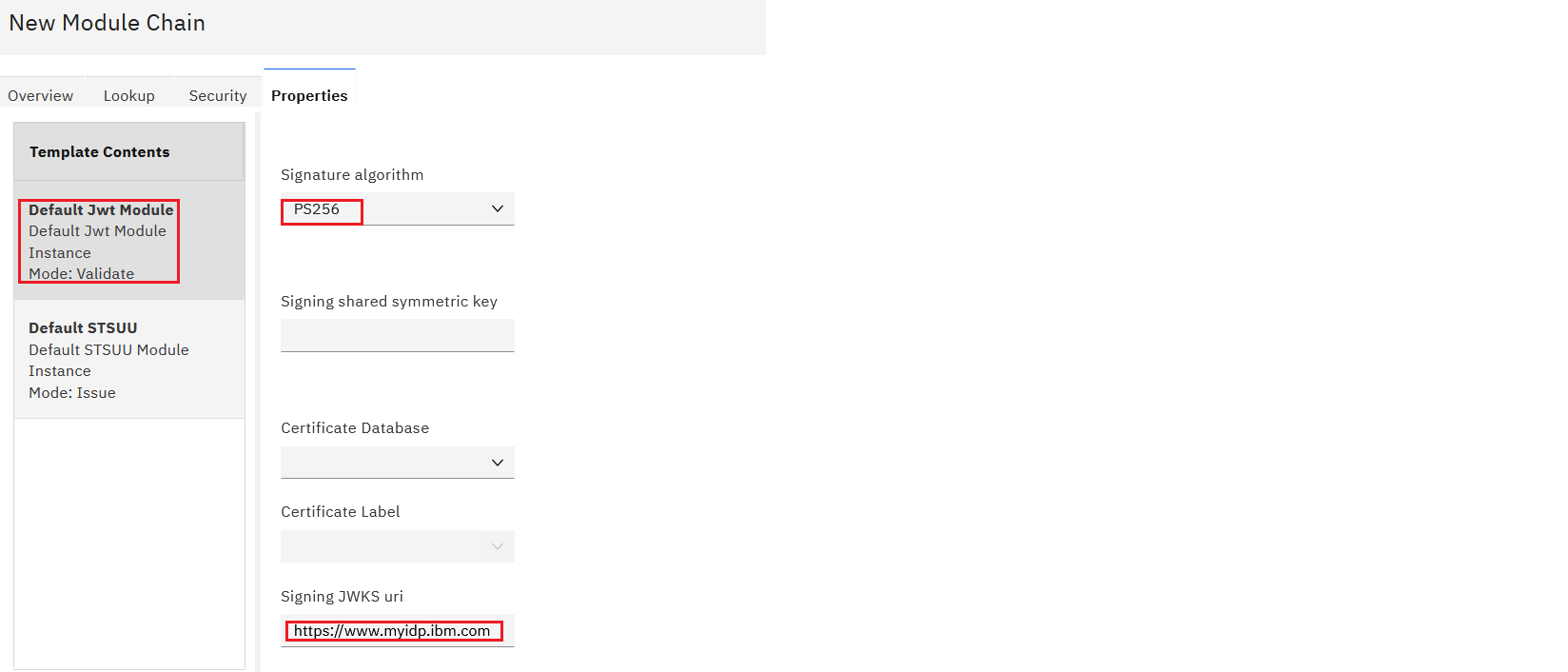

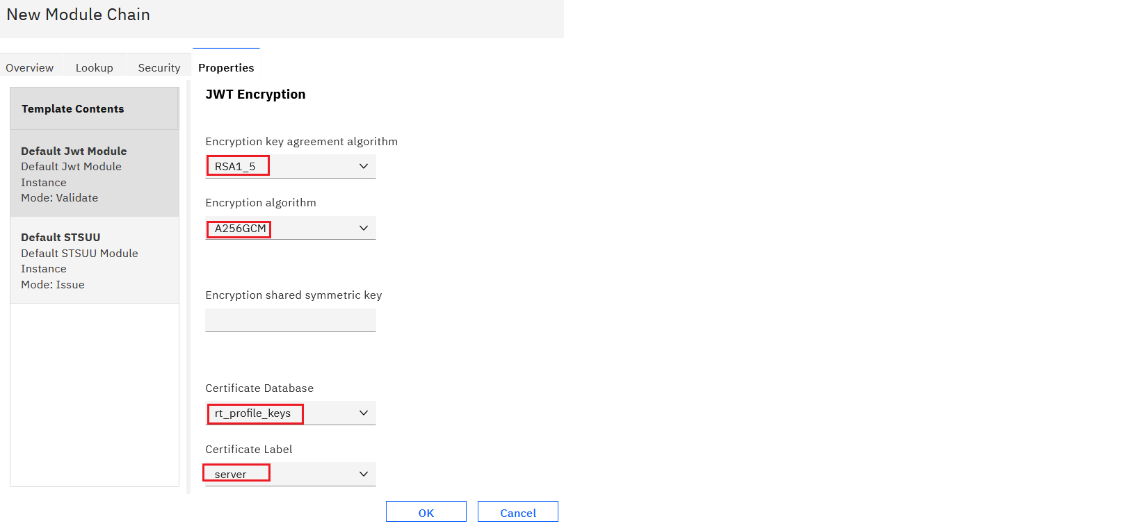

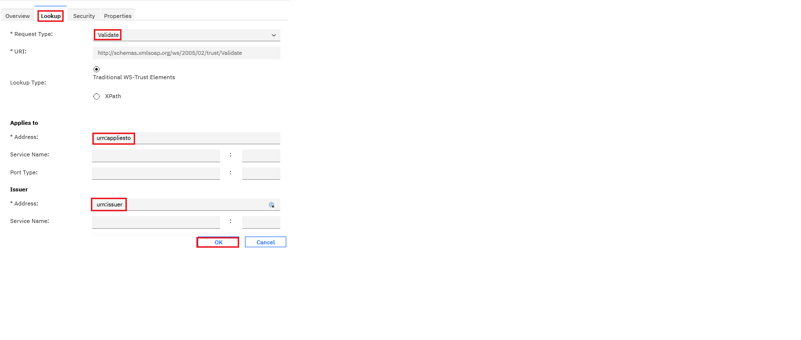

- Configure an STS Chain with the template created in the previous step. Configure the Lookup tab and Properties tab with JWT Signing and JWT Encryption settings.

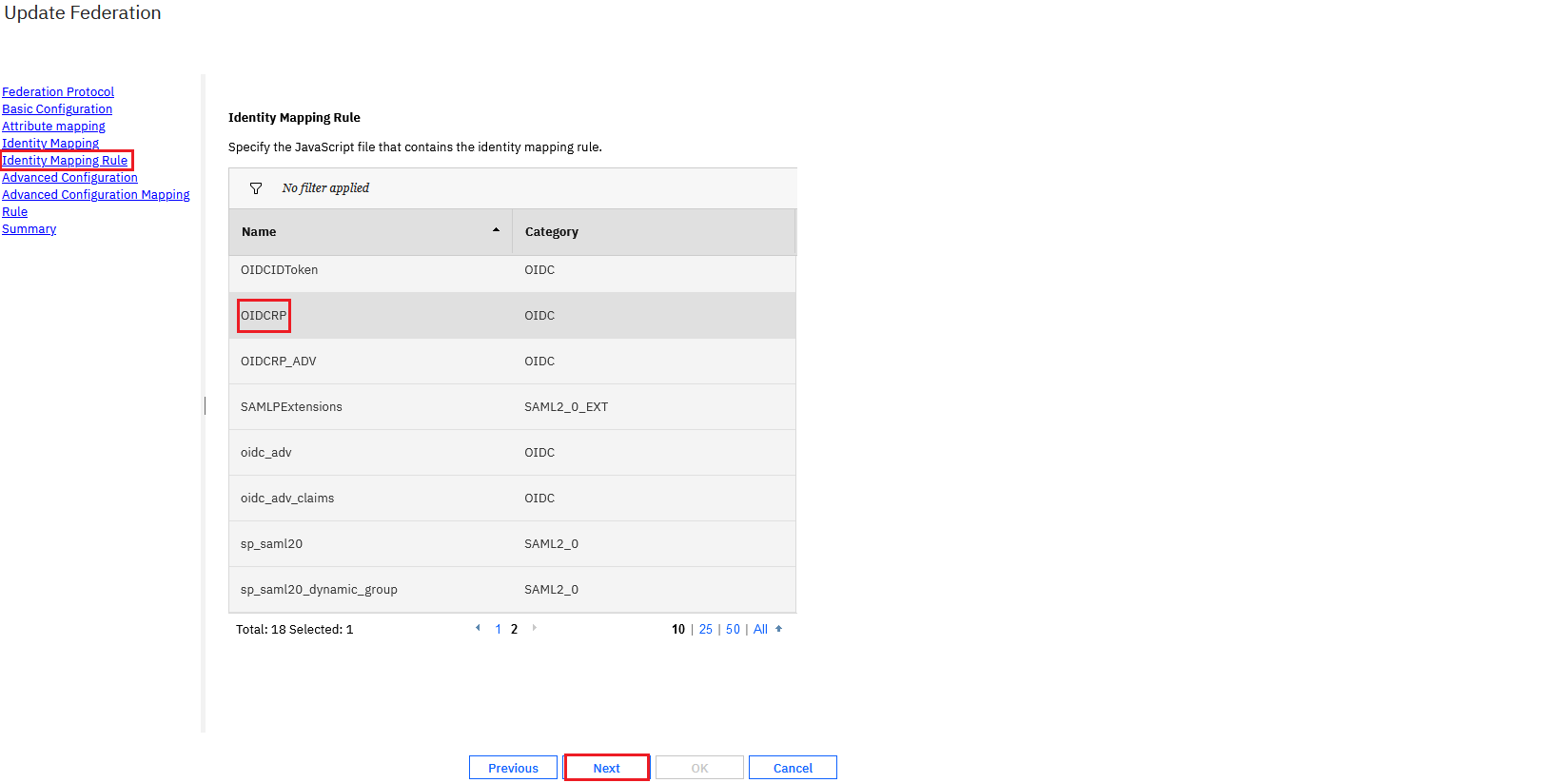

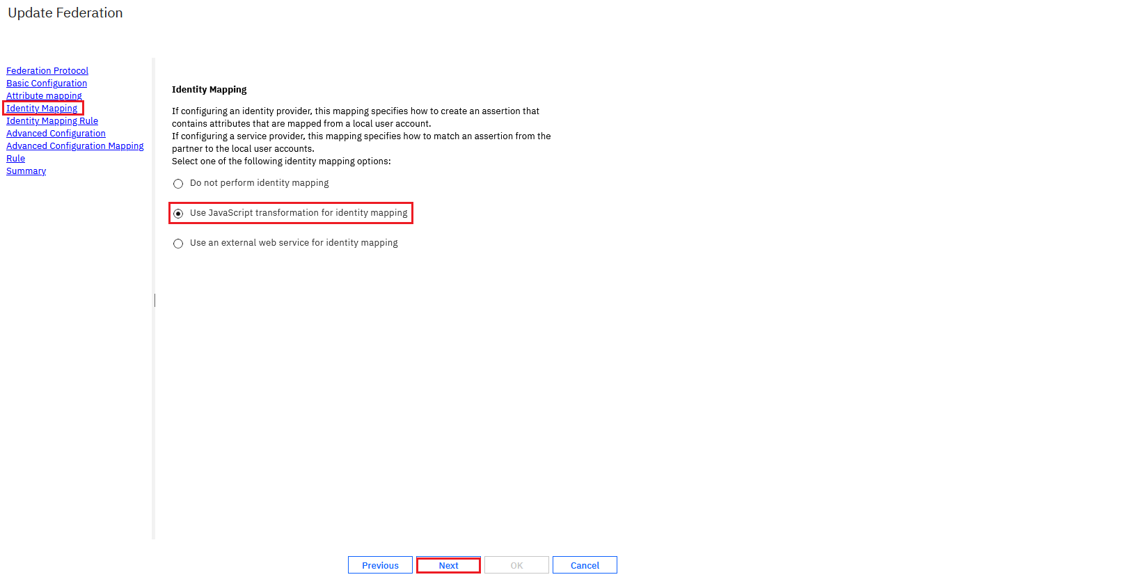

Navigate to Federation -> Federations. Edit the OpenID Connect Relying Party federation.
.- Navigate to Identity Mapping -> Use JavaScript transformation for identity mapping.
- Select the identity mapping rule OIDCRP.
- Save and deploy pending changes.

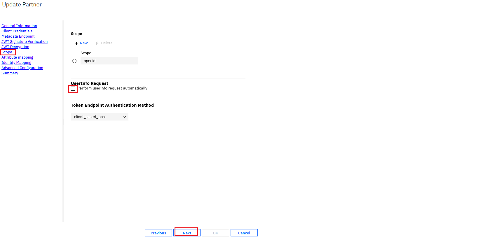

Navigate to Federation -> Federations. Select the federation and click Partners.
- Select the partner and edit.
- Navigate to Scope configuration and uncheck Perform userinfo request automatically
. - Save and deploy pending changes.
