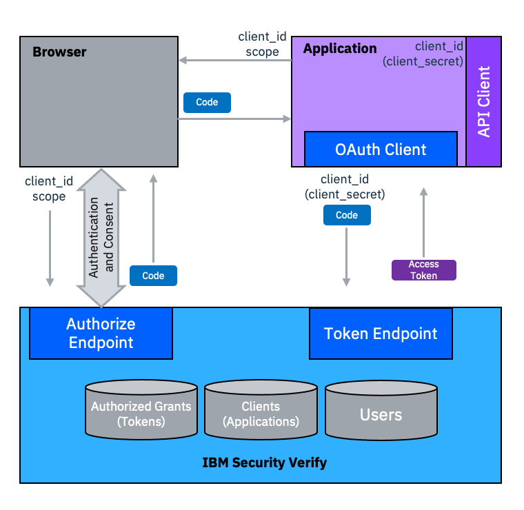

The Authorization Code grant type is the most commonly used and most widely supported. It is a popular choice for services that offer APIs to be consumed by 3rd party web applications. The Authorization Code grant type flow requires the use of a browser. For mobile applications, this could be an embedded browser.
In this flow, the end user authenticates and provides consent directly to the Authorization endpoint of the OAuth Authorization Service. This is a browser endpoint and the method by which the end user is authenticated, and the user experience for user consent, are completely under the control of the Authorization Server.
Once authentication and consent are complete, the Authorization Service generates a short-lived, single-use, Authorization Code to be returned to the application. It is this authorization code that gives this grant type its name.
When the application receives the Authorization Code, it makes a direct connection to the token endpoint of the Authorization Service and exchanges the Authorization Code for an Access Token.
