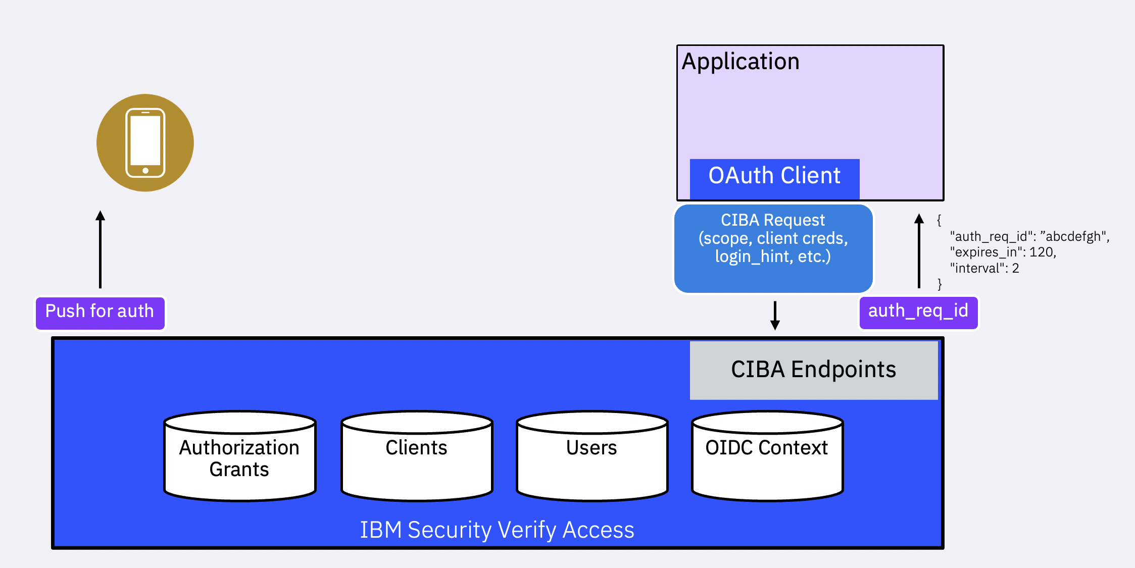

The CIBA flow is started when an initial request is received at the /oauth2/ciba endpoint. At the minimum, the request contains client authentication credentials (such as a client_id and secret or a private key signed JWT, etc.), scope to indicate requested permissions and user data, and a hint that identifies the user uniquely. The hint may be provided as a login_hint, login_hint_token, or id_token_hint parameter.
The OIDC Provider responds with auth_req_id. The client uses this in subsequent requests to the /oauth2/token endpoint to obtain the requested tokens.

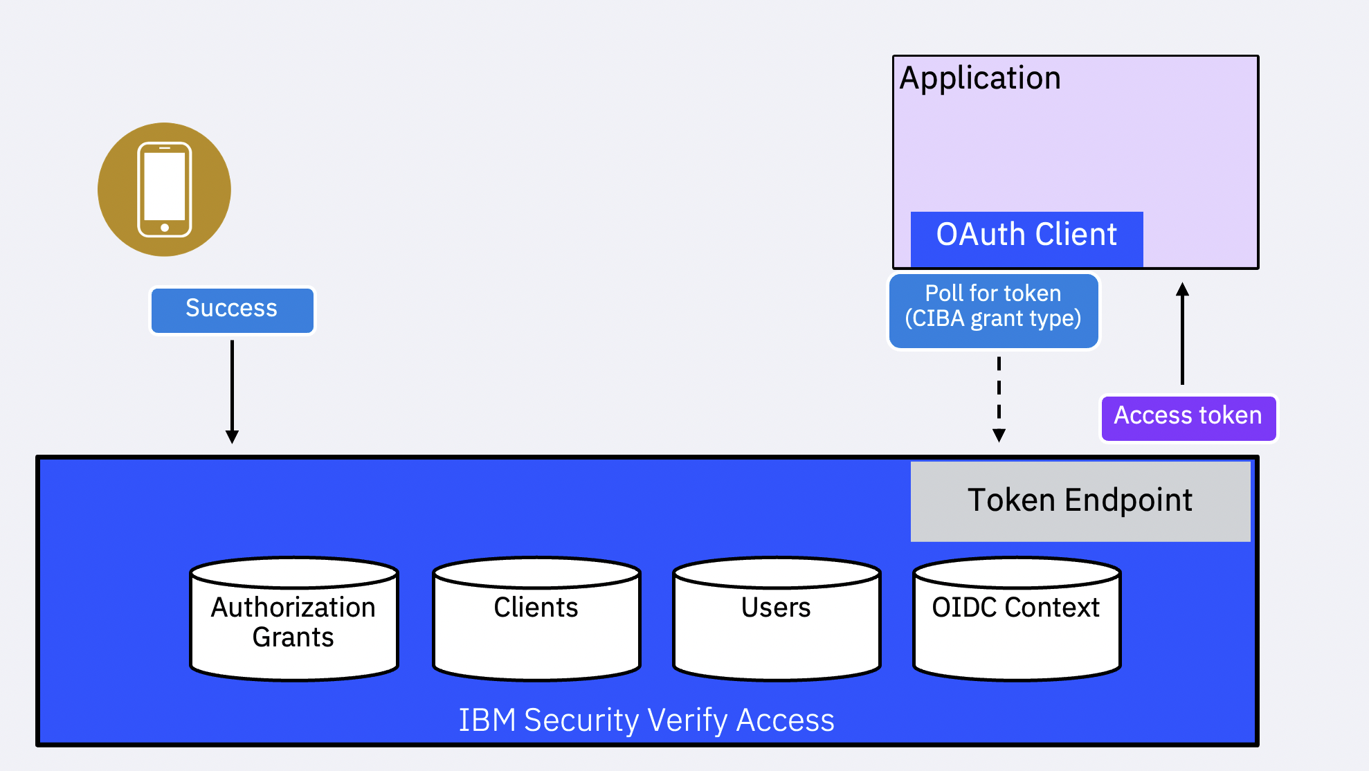

The relying party (client) calls into the /oauth2/token endpoint with client credentials, the grant type urn:openid:params:grant-type:ciba and the auth_req_id. The OIDC Provider responds with a specific error code if the authentication flow has not been completed.
