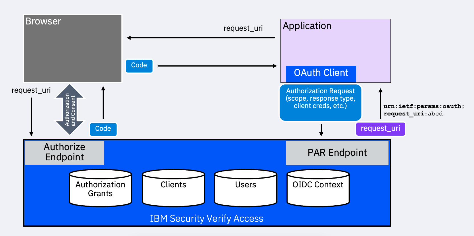

The Pushed Authorization Request (PAR) enables a Client to push the payload of an authorization request directly to the authorization server. A request URI value is received in exchange that is then used in the authorization request through the user agent. The OIDC Provider is able to reference the request based on the request URI.

PAR, on the other hand, pre-registers the request parameters and the request_uri contains an identifier generated by the OIDC Provider itself that keys it to the request parameters. The Client must authenticate itself using any of the client authentication methods configured, such as using a client_id/secret or private_key_jwt assertion. This presents a simple mechanism to address the challenges and reject requests early if they fail validation at the OIDC Provider.
The process of exchanging the code for tokens remains the same as the standard grant flow.
