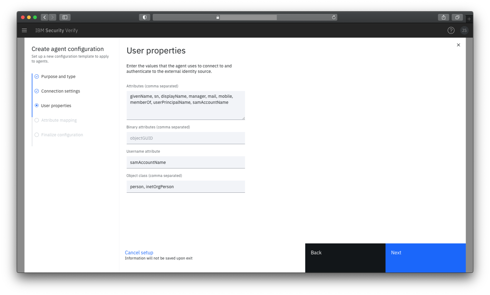

User properties
The default values provided on this panel are good defaults for Active Directory.
If you plan to provide Single Sign-On to Microsoft Office365 then it is likely you will need the objectGUID binary attribute (which is used to link users in Azure with users in on-premises Active Directory).
Exploring Active Directory attributesIf you want to see the attribute names (and values) for attributes in your Active Directory, you can do this in Active Directory Users and Computers by enabling Advanced Features under View menu. This causes a new Attribute Editor tab to shown when you open user properties.

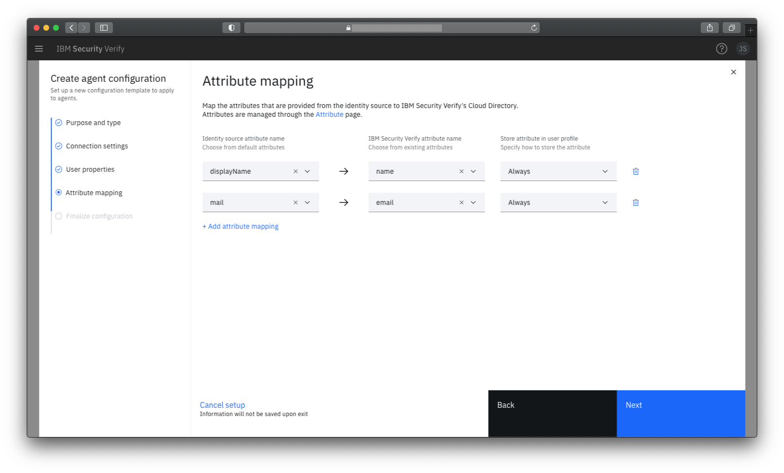

Attribute Mapping
An attribute mapping entry links a source attribute from Active Directory with a target user attribute in IBM Verify.
When a user authenticates via the bridge, the values of the source attribute from Active Directory will override the values of the target attribute in IBM Verify for the current session.
It is also possible to specify that the values read from Active Directory should be stored in the user's Cloud Directory entry in IBM Verify - overwriting any existing values. This can be done either on first access only - or every time a user authenticates.

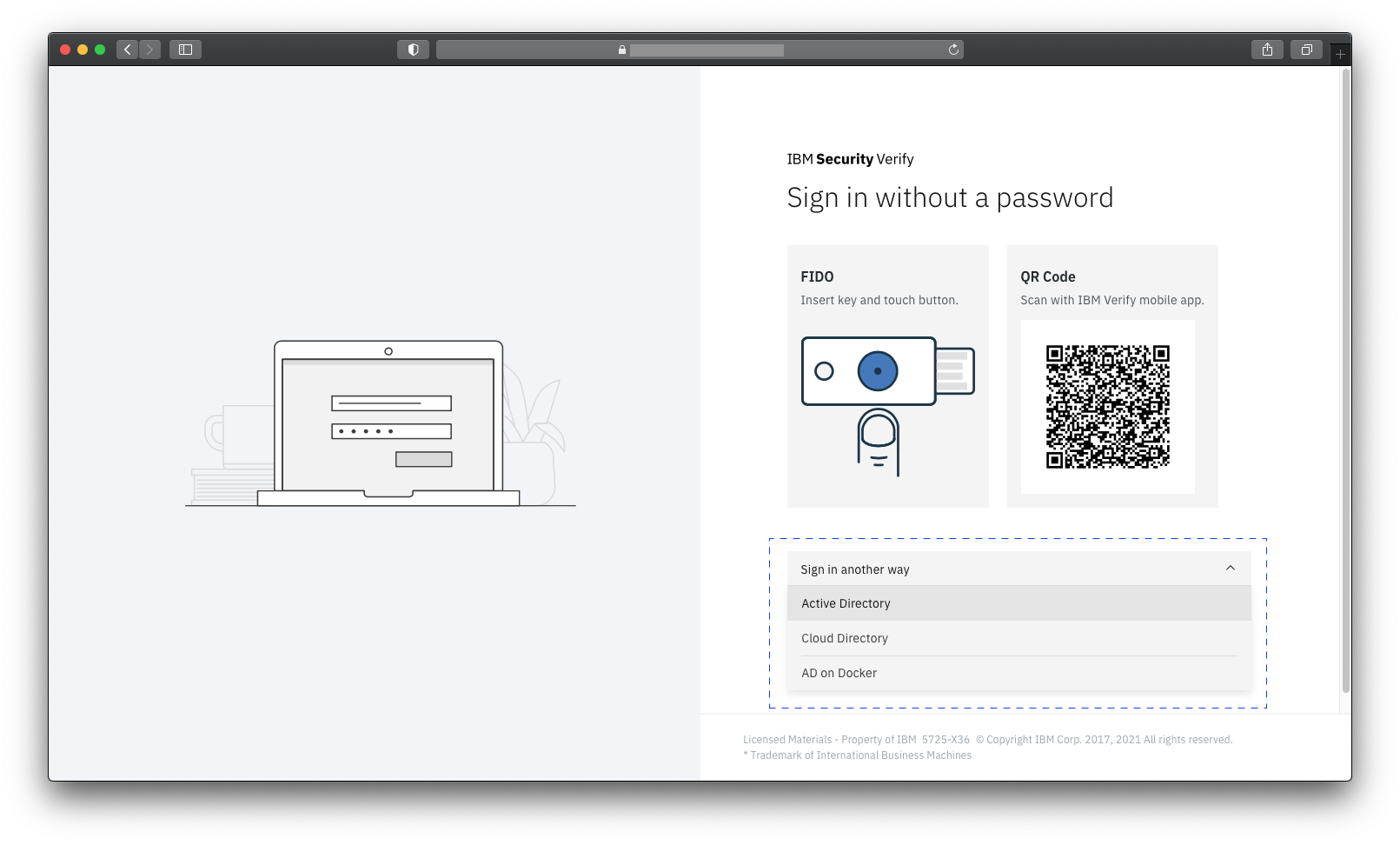

To test the bridge end to end, attempt to authenticate to your IBM Verify tenant using a username and password from your Active Directory.
On the default login page, click Sign in another way and select the identity source associated with your bridge from the drop-down list.
Enter the username and password of a user from Active Directory. If everything is working the user should be successfully logged in.
If the authentication fails, check the trace file of the bridge service for debug information.
