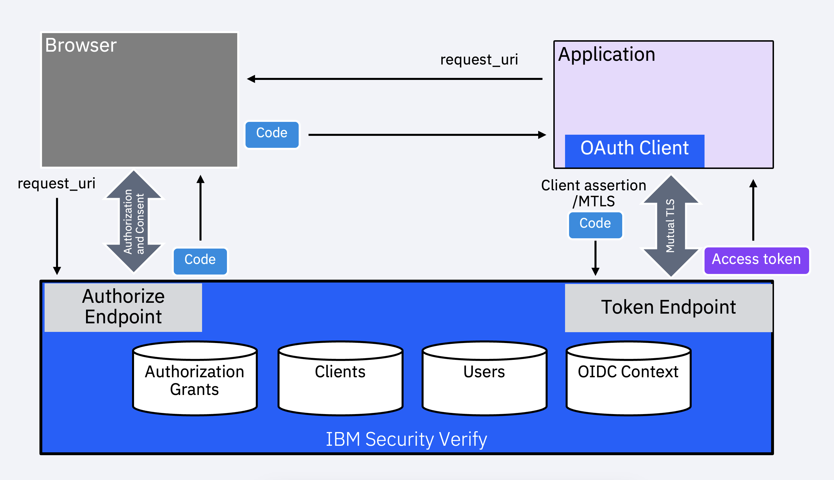

Certificate-bound access tokens (sometimes also called Mutual TLS sender-constrained tokens) are bound to the underlying mutual TLS connection between the client and the authorization server (like IBM Verify). As part of the OAuth 2.0 grant flow, the underlying connection to the token issuance endpoint is secured using mutual TLS. After a successful transport connection is established, the authorization server encodes the thumbprint of the client certificate and stores this in the authorization grant as part of the "confirmation" claim (cnf). This is then made available as part of token introspection response or embedded within a JWT-formatted access token.
The process is illustrated in the flow below. The application (client) initiates an authorization code flow via the browser to obtain an authorization code and then uses that to request for a token.

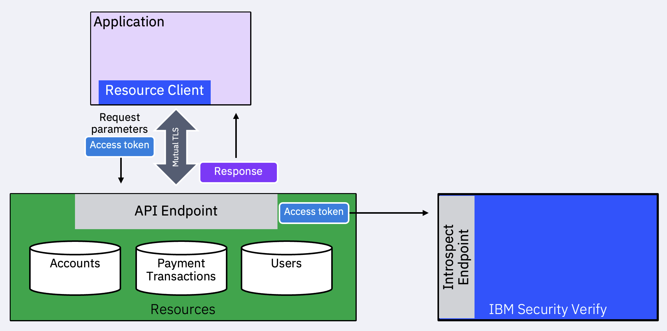

When the client accesses a protected resource API authorized using the Bearer token, it is now required to use the same client certificate to establish a mutual TLS connection. This enforcement occurs at the resource endpoint (or at the API gateway/proxy, where the TLS connection terminates).
The API (or gateway) introspects the token (if it is not a JWT) and does the following:
- Generate the encoded thumbprint: The value is a Base64URL-encoded RFC4648 SHA-256 hash (a.k.a., thumbprint, fingerprint, or digest) of the DER encoding of the X.509 certificate.
// Importing crypto module
const {X509Certificate,createHash} = require('crypto');
// PEM-encoded X.509 certificate, usually extracted from the request object
const pem = '...';
// Getting object of a PEM-encoded X.509 Certificate.
const x509 = new X509Certificate(pem);
// Compute the thumbprint hash
const thumbprintHash = createHash('sha256').update(x509.raw).digest('base64url');-
Introspect the Bearer token or validate the JWT (if formatted in this manner).
Extract the
cnf.x5t#s256value and compare with the thumbprint hash computed in step 1. If they match, perform other authorization decisions, such as comparing scopes granted, etc.
