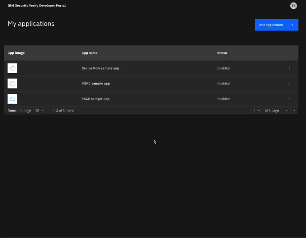

  1. Access the Developer Portal from your IBM Security tenant. Usually, you can find the portal as a tile in the end-user launchpad.
  2. From the My applications page, select your application and then click the App setup link that appears at the top of the details sidebar.
  3. Select the node.js tile.
  4. Select the Download app button. This downloads a ZIP file that contains the sample application.
620

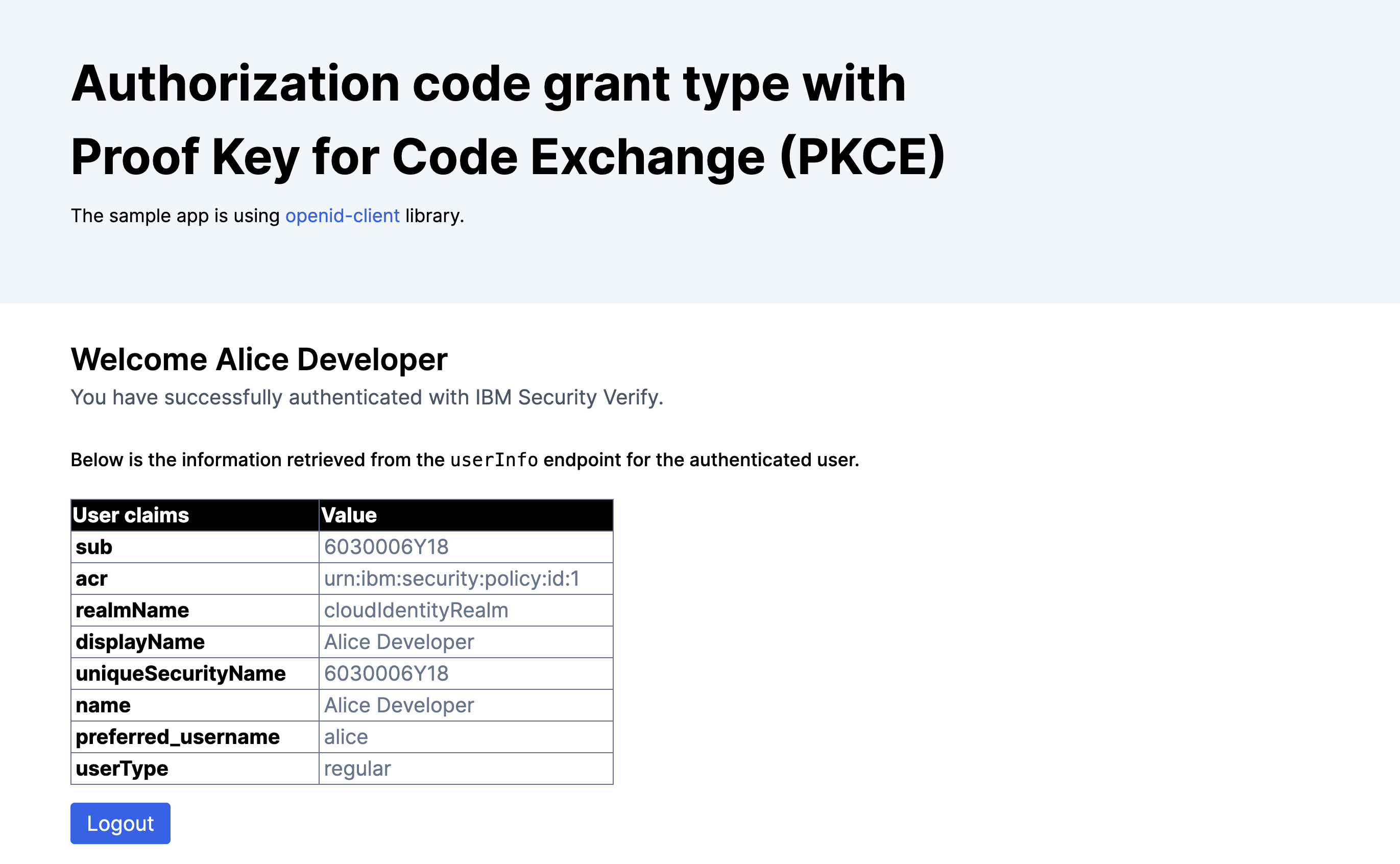

Once authentication is complete, you are re-directed back to your sample application. The single sign-on flow is completed to get access to identity information for the user that authenticated. The information received is displayed in the browser:
2742
