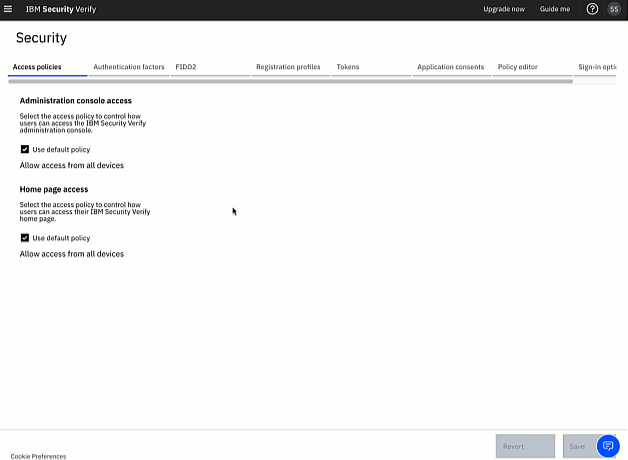

In your tenant admin UI, navigate to the Security page. The Portal access tab is shown when this page opens.
Navigate to access policies configuration
On this page you can see that the system is using the default policy for both administration console access and homepage access. You can see that the default policy is Allow access from all devices. This is a permissive policy which always allows access with no second factor authentication.
Select policy for administration console access
To set a non-default access policy for administration console access, clear the Use default policy checkbox and then click the edit icon which appears. A list of available access policies is shown.
Select the built-in Require 2FA each session in all devices policy. A description of the policy is shown.
Click OK to accept the policy. The policy is now displayed in the Administrative console access section of the configuration screen.
Click Save to save the updated configuration.

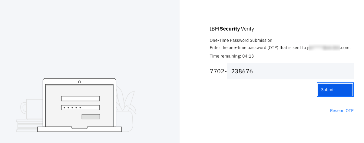

In a different browser, navigate to the administration console of your Verify tenant. The login page is displayed.
Authenticate as you usually do.
When this first factor authentication is complete, the new access policy is invoked and you should be prompted for 2nd Factor Authentication. If you have multiple factors registered you will see a selection page. If you only have one factor registered, you will see a challenge using that factor.
Complete 2FA authentication. You can now access the Administration console.
