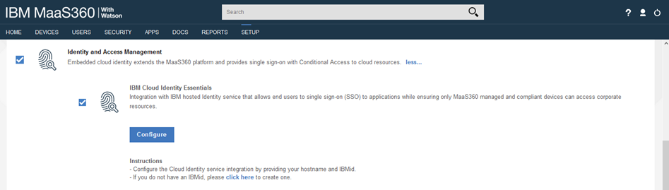

Enable the Verify service in MaaS360
- In the MaaS360 portal, select SETUP > Services and find Identity and Access Management service.
- Enable it and click Configure.
- You need an IBM ID to configure the Verify service.
- Enter a hostname to register for your Verify tenant
- Note: Usually this is your company name (ex. company for company.verify.ibm.com)

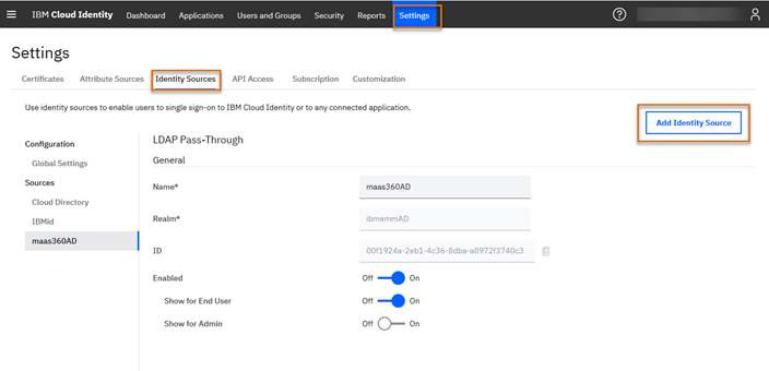

In the Verify portal, click Add Identity Source.
Type a Name and a realm. Name is the name that you assign to represent the user registry that is used by identity providers such as Microsoft Active Directory, Microsoft Azure Active Directory, or others. Realm is an identity source attribute that helps distinguish users from multiple identity sources that have the same user name. In both cases, you can enter whatever value you want in these two fields but make them meaningful to your environment.
Enable the new Identity Source by setting Enabled to On. When the identity source is configured and enabled, users can single sign-on to Verify and into their entitled applications with the selected identity source. Set Show for End User to On for all end users sign in page. You can also enable it for Administrators if you want them to use LDAP Passthrough for authentication. Note that the sign in page is only displayed to the mobile user if the certificate authentication fails.
When you save the new Identity Source, a unique ID is generated and the new Identity Source displays in the list of Sources. Disable the other Identity Sources that you will not be using.

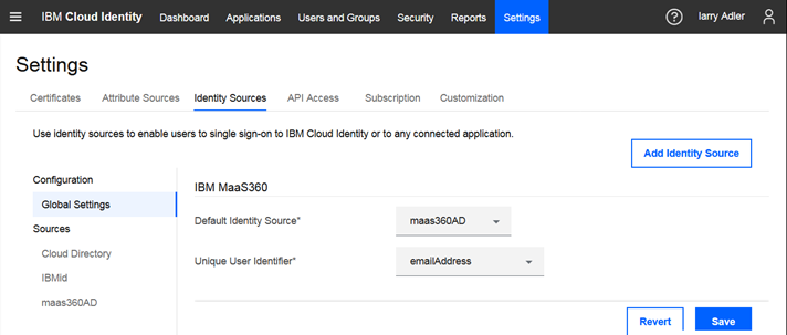

Next, go to Global Settings and select your new Identity Source in the Default Identity Source field and select a unique user identifier. The unique user identifier is used to identify IBM MaaS360 users who access Verify.

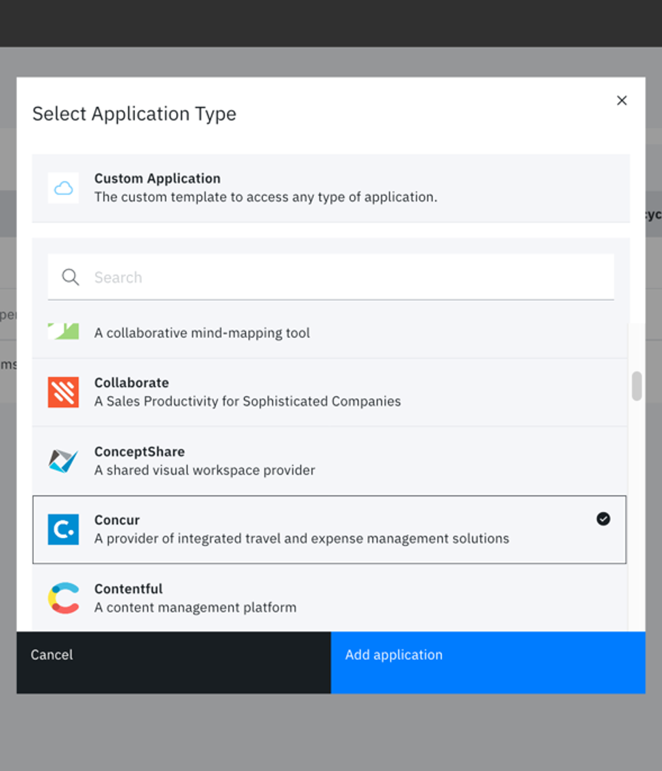

Configure the cloud apps that your mobile users will be accessing from their mobile device. If you want your MaaS360 mobile users to have seamless SSO and to control access based on their MaaS360 compliance status, for example: Salesforce and Box, you must select these predefined connectors in Verify and configure them for federated SAML authentication. When the mobile user accesses the app from their device, the authentication request goes to the cloud app, such as Salesforce, and Salesforce redirects the request to Verify. The connector configuration enables that redirection and authentication to happen. Each connector has detailed configuration steps that you follow.
If certificate authentication fails, the user will be redirected to their identity source to enter their user name and password (access to the application depends on your access policy). If certificate authentication succeeds, the user will automatically be authenticated and will not be shown a user and password log in screen.
When you select an application, you are also provided with a risk score and details from IBM X-Force Exchange. You can also link to X-Force Exchange for risk details.

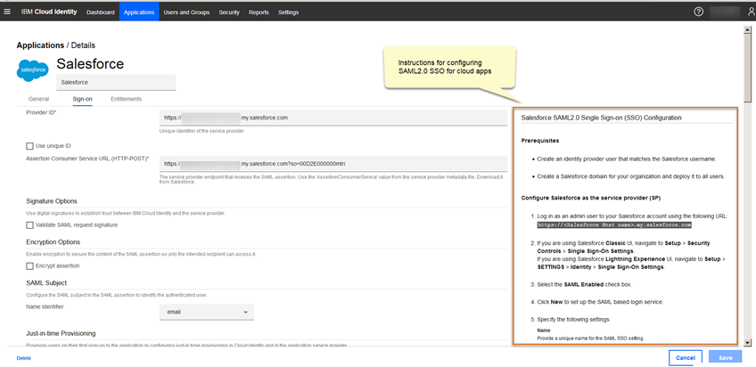

Verify provides detailed configuration steps for each cloud app connector. You will also need to log in to the cloud app, for example, Salesforce to complete configurations and gather parameters for the connector.

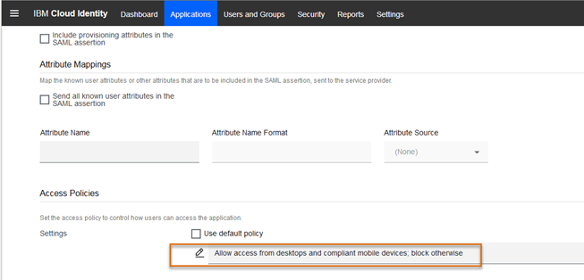

When the Sign On configuration is complete, you must also select the Access Policy for the application. This is where you can identify access criteria. For example, if you only want managed, compliant devices to access Salesforce, all other devices will be blocked from access. So, if you have a device user that is not enrolled in MaaS360, they will not be able to access the app. Or if they are enrolled in MaaS360 but are not in compliance with mobile policies, they will not be able to access the application.

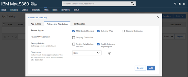

In the MaaS360 portal, you must add the mobile apps to the MaaS360 App Catalog and set Enterprise Single Sign On. Or if you have existing application in the catalog, you can edit the app catalog entry to set enterprise single sign on. Therefore, if you configure a Salesforce connector in Verify, you must add the Salesforce mobile app to the MaaS360 App Catalog and Enable Enterprise single sign-on.

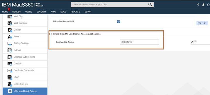

Set SSO Conditional Access in MaaS360 policies
Depending on the mobile device type: iOS, Android, or Windows 10, you must update the MDM policy in MaaS360 to enable SSO Conditional Access for the apps. The apps display in the Application Name selection based on Enterprise Single sign being checked in the App Catalog. After you save and publish the policy, the updated policy must be assigned to the mobile devices to take advantage of SSO and conditional access. This can be accomplished by setting the policy as the default, assigning the policy to a device group or single device.

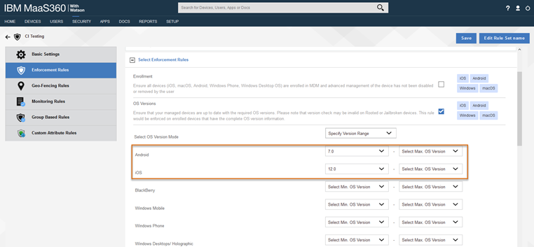

[Optional] Configure Compliance Rules in MaaS360
You can also configure compliance rules in MaaS360 to evaluate whether a device is compliant based on criteria you set. Compliance rules are very flexible; there are standard compliance conditions, such as checking for jailbroken devices, or making sure the device has a current OS version. You can also create custom compliance conditions based on group based rules and custom attributes. Configure the Compliance Rule and assign it to mobile devices by making it the default or assigning to a device group. If the device is marked as out of compliance and you set the access controls in Verify to check for compliance, then the device will not be able to access the cloud apps you configured for SSO Conditional Access.
