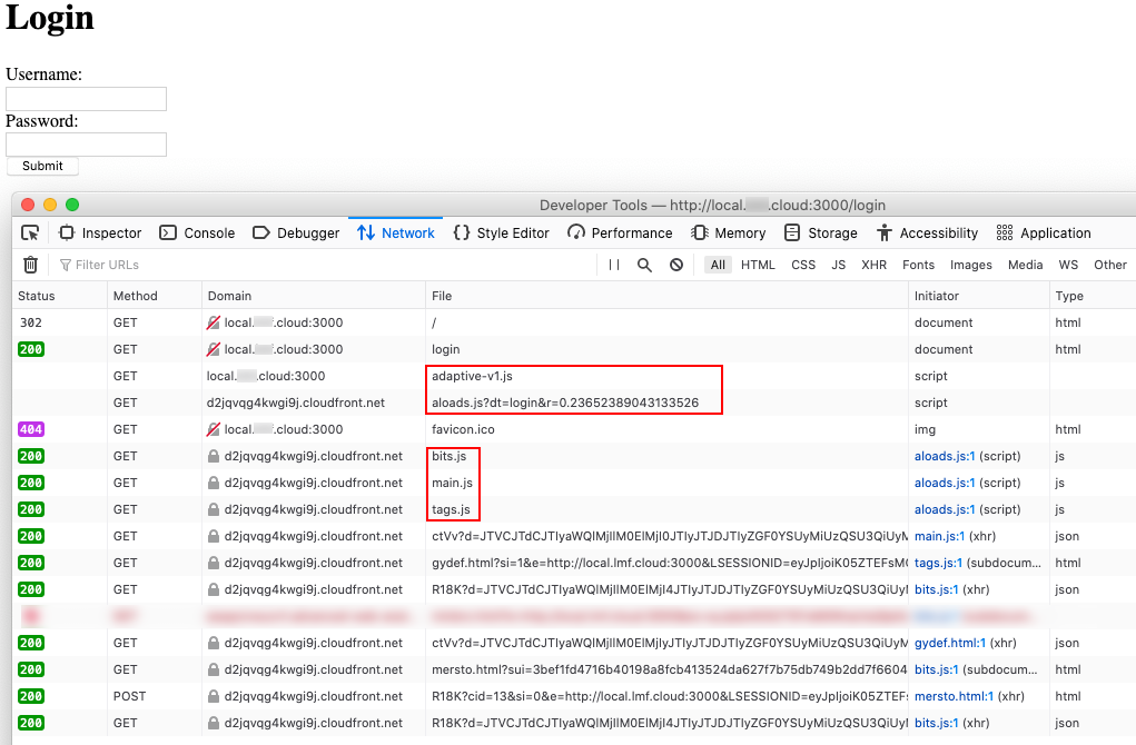

Collection did not commence
When the Browser SDK is initialized on the login page, as described in Ensuring Collection Completes, if the collection does not start, no Session ID will be provided and the call to getSessionId() will not return the correct value.
User the Developer Tools in your browser to check that collection and detection has started.
You should see requests in Network tab that include a request to the cloudfront host specified in the web snippet that was generated during on-boarding the native application
For example https://d1anfu45urknyg.cloudfront.net/511843/aloads.js?dt=login&r=0.3289762412868322.
You should see additional JavaScript loaders requested, which may include
- bits.js
- main.js
- tags.js
These loaders should return a 200 response code with a non-empty response body.
Additionally, you should see multiple requests to the same cloudfront host with different URI paths as the collection continues.
If you do not see these requests, ensure you have:
- accessed your Native Web application using the same domain name specified for
Allowed domainwhen On-boarding your native application. - correctly loaded the Browser SDK to start the Adaptive access collection and detection as described in Ensuring Collection Completes
- exposed the static resource as described in Hosting a Well-Known Static Resource
