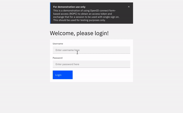

Sample form-based login flow example
I have put together a sample application, no more than 160 lines of HTML/JS code. This application does one thing, and one thing only: logs a user in to the launchpad from an third party application.
