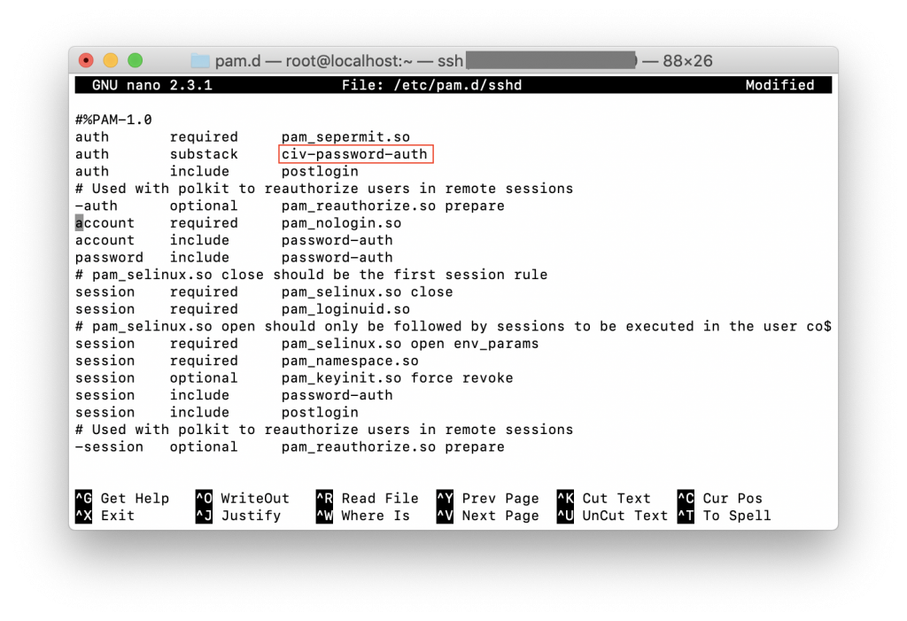

Setup PAM for SSH Multi-Factor
To use IBM Verify with SSH, you must edit the PAM configuration for sshd.
- Copy the Password Auth File
- The file /etc/pam.d/sshd controls the SSH authentication. However, it uses a common include file for the authentication, /etc/pam.d/password-auth. Run the following command:
cp /etc/pam.d/password-auth /etc/pam.d/civ-password-auth
- Edit the new civ-password-auth File
- Using your favorite editor, make the following changes to the /etc/pam.d/civ-password-auth file.

In the file /etc/pam.d/sshd, in the auth stanza only, replace password-auth with civ-password-auth.

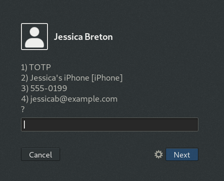

Test the Configuration
Back in the terminal window, perform a localhost SSH connection using the following command:
ssh testuser@localhost
You should first be prompted for your local password to the system, then a call will be made to Verify to obtain the 2FA enrollments for the user.
[root@localhost ~]# ssh testuser@localhost
Password:
1) 15125551012
2) [email protected]
? 2
Enter OTP ####-######
[testuser@localhost ~]$Additional steps
