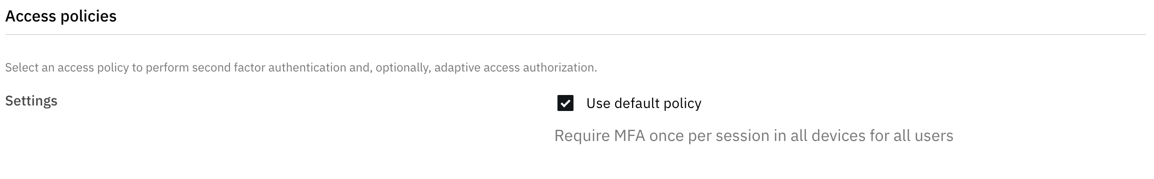

Access policies in IBM Verify provide a context rich authorization framework to facilitate a frictionless user experience whilst protecting your critical business applications from unauthorized access.

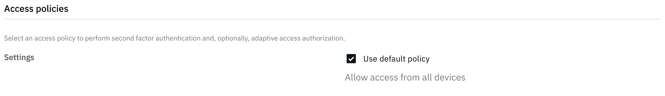

When a new application is created, the Use default policy box is checked under Access policies in the Sign-on tab. By default, the Allow access from all devices Access policy is selected and no evaluation will occur when the application is accessed.

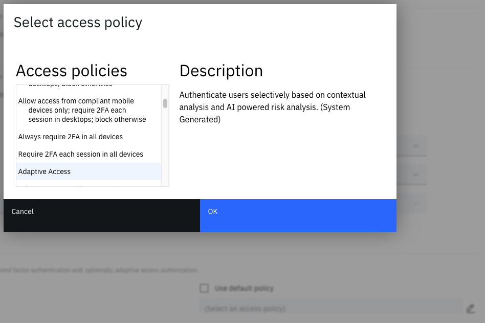

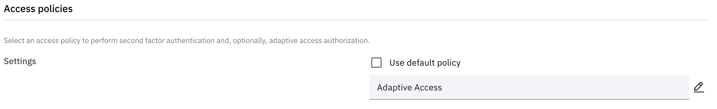

In many cases a predefined or custom Access policy is required and must be manually selected and assigned.
Following selection, the chosen Access policy will be evaluated once the changes to the application have been saved.
This process is sufficient for a small number of applications and demonstrations, however can become tedious to apply to more than a few applications and can lead to missed configuration and therefore unauthorized access and audit exposures when manual assignment is required across a large number of applications.

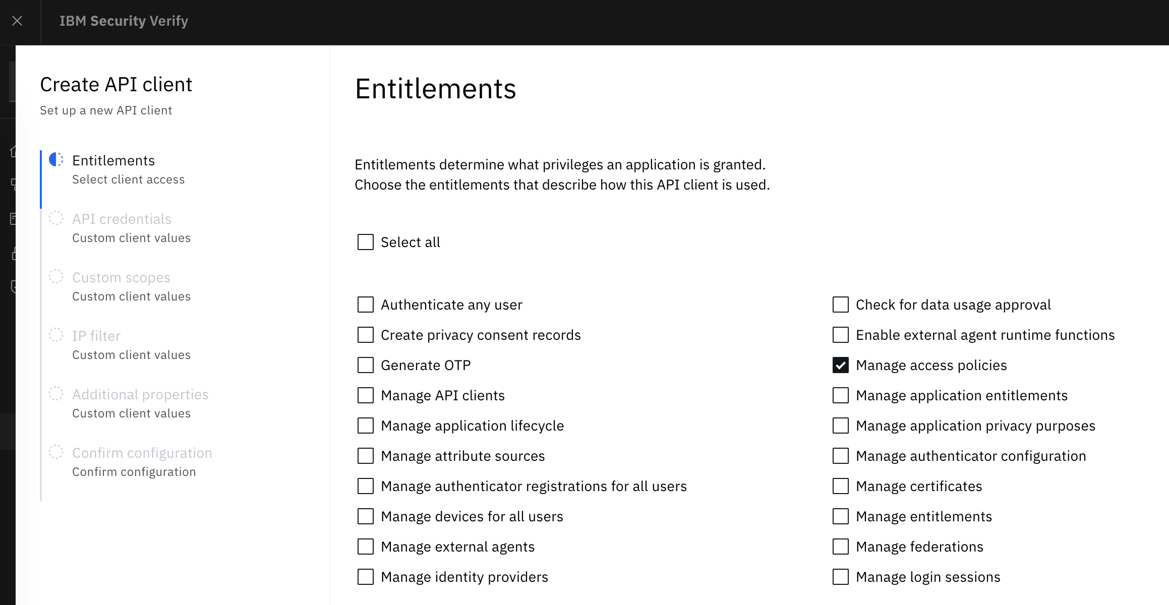

Create API client
You can create, or reuse an existing API client.
Refer to Create an API client and follow the steps for Option 1 - Stand-alone API client.
When selecting the Entitlements only Manage access policies is required for this scenario.

Test the default Access policy
The "tenantDefaultPolicy": true setting will take immediate effect and will overwrite any previously assigned default Access policy.
You can validate the update by creating a new application, or editing an application where the Use default policy box is checked, ensuing the Access policy name of the updated policy is displayed.
When accessing that application, the assigned Access policy will be evaluated.
To reinstate usage of the default in applications, instead of manually assigning an Access policy, simply edit the application, check Use default policy and save the changes.
The assigned default Access policy is not currently enforced for Portal Access of Administration console access or Home page access.
In Portal Access, whenUse default policyis checked the labelAllow access from all devicesis displayed indicating an updated application application default policy is not applied here.
Manually select the Access policy and save changes to override the Portal access policies.
Remove or modify the default Access policy
If you need to change the behavior of the default Access policy you can
- Update the Access policy currently assigned using APIs or the Access Policy Editor; if you don't provide the
tenantDefaultPolicythe currently assigned value will remain - Assign a new Access Policy by following the steps in Update the custom Access policy to be the default with a different Access policy ID
- Update the Access policy currently assigned using APIs to set
"tenantDefaultPolicy": falsewhich will revert back toAllow access from all devices
